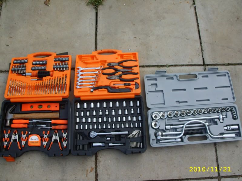

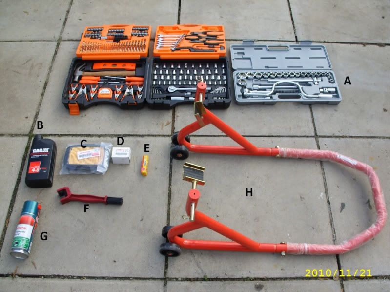

Tools and things pictured:
A. Wrenches and common tools

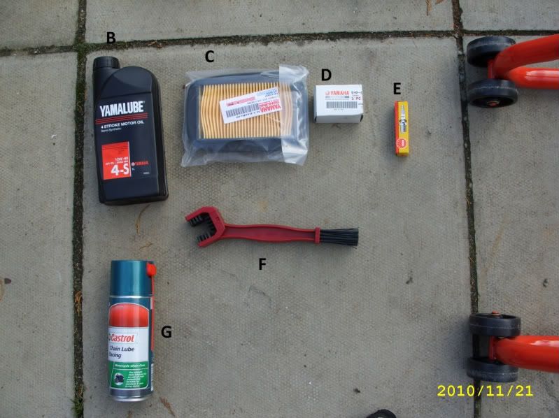

B. Yamalube 4-S 10w/40 Semi-Synthetic
C. Genuine Yamaha Air Filter
D. Genuine Yamaha Oil Filter
E. NGK Spark Plug CR8E
F. Chain Cleaning Brush
G. Castrol Racing Chain Lube
H. Biketek Paddock Stand

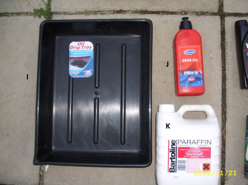

I. Oil Drip Tray
J. Gear oil 80W-90 (not required to put in the bike, this is used for cleaning / lubricating the chain).
K. Paraffin/ Kerosene (both the same thing )

1. Set of wrench with different size sockets

I’m going to go along as using a paddock stand as I’ve got it and you lot should buy it but the side stand would do.

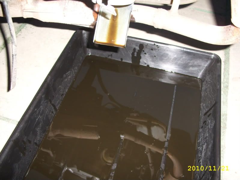

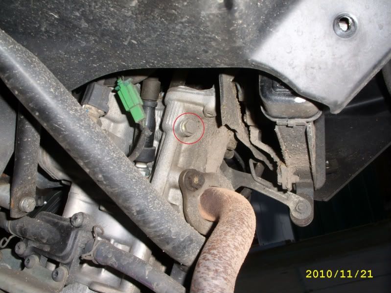

Position the bike on the paddock stand and put the oil drip tray right under the drain bolt also from under the riders seat where the original toolkit is kept there is a mini metal tray which is called “engine oil drain attachment” it directs the flow of oil away from the exhaust if you haven’t got it not a big deal you will just have to clean your exhaust after.

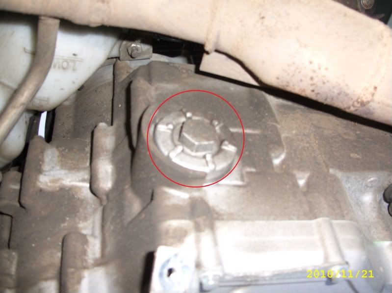

This is where things get dirty and oily start by removing the oil filler cap (dipstick) then unbolt the drain bolt and be careful as there is a spring and a strainer, which will come out flying if you don’t remove the drain bolt slowly, just accept your hands will get dirty.

Once all the oil has drained out you need to put the drain bolt back in this is where you need to be a little carful as you have to put the oil strainer then the spring and then the drain bolt, start turning the drain bolt by hand then tighten it to 32Nm.
